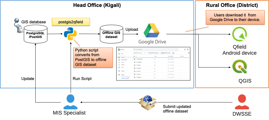

The most significant thing after data collection is updating. We have seen many organization in Africa, which failed to keep data up to date. Several years later, their data will normally become too old, and most of them need to put efforts on data collection again. WASAC decided to continuously update all of the data and keeps doing this until now. QField has proven to be very well suited for this purpose. In order to distribute and updating the data, we developed a python script postgis2qfield. This postgis2qfield tool can extract the data from PostGIS and create Geopackages for each district in Rwanda. We upload these 27 geopackage together with QGIS project template to Google Drive storage. After that, those engineers in districts download their geopakage to Android device to continue adding and updating the data. Once they completed updating, they sent the geopackage to central office again, MIS specialist update PostGIS database and regenerate geopackages for QField.
Data distribution and updating procedure
