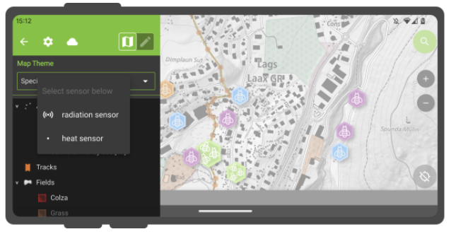

The breakthrough came through integrating radiation detection instruments directly with QField. Working with the QField development team, the specialist created a system that captures gamma radiation readings every second while simultaneously recording precise GPS coordinates.
This sensor integration capability was initially developed specifically for QField to meet the growing demand for real-time sensor data collection in field applications. However, following open-source best practices, OPENGIS.ch contributed this functionality upstream to the broader QGIS project, making sensor integration available to the entire QGIS ecosystem.
“We basically just measure the offset from our detector bottom to the antenna to get our elevations,” explains the specialist. “The detector spits out data every second, and QField captures both the radiation reading and the location simultaneously.”

Using QField’s sensor integration capabilities, radiation data flows directly into the mapping interface with custom delimiters to parse the incoming data stream properly.
