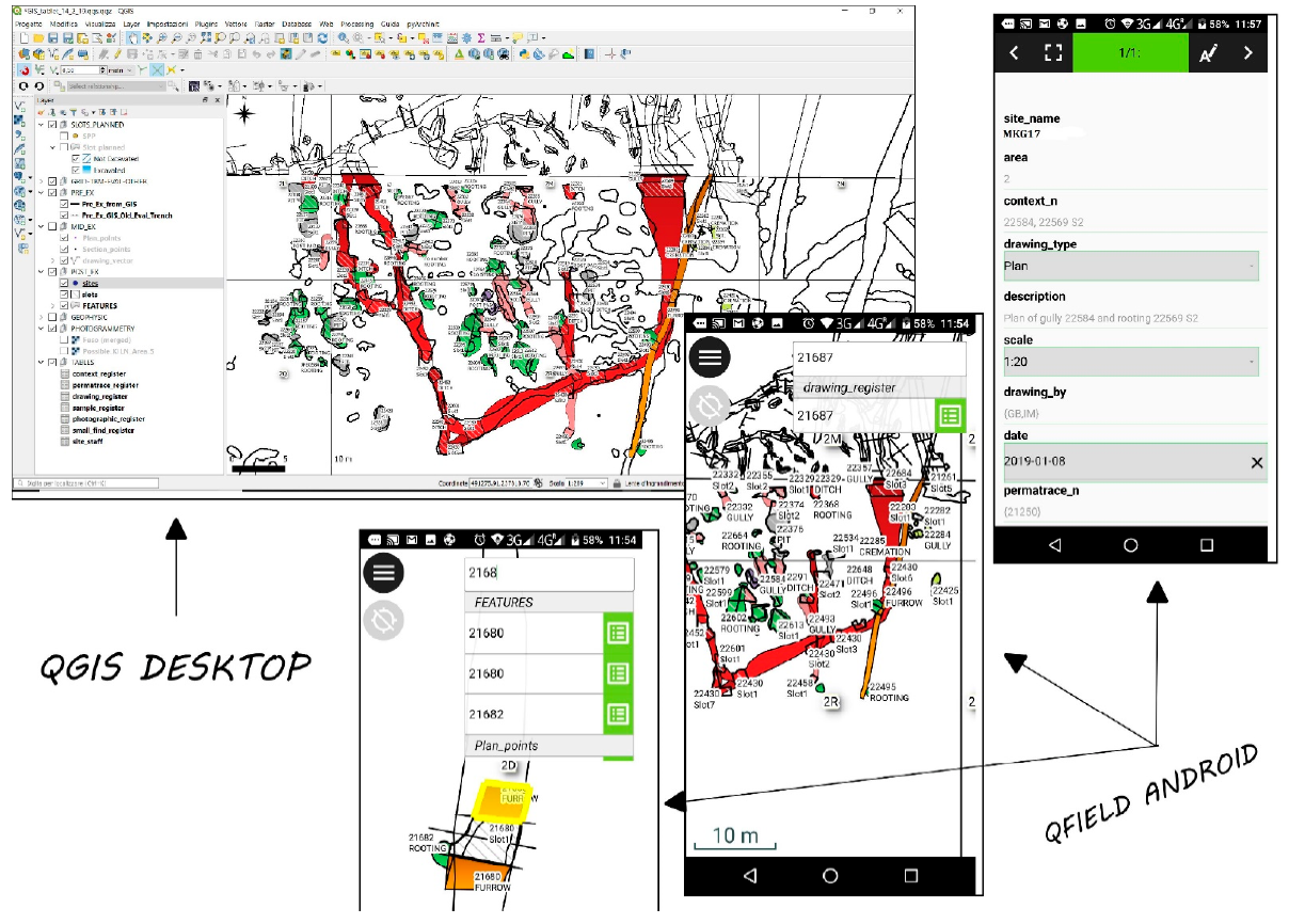

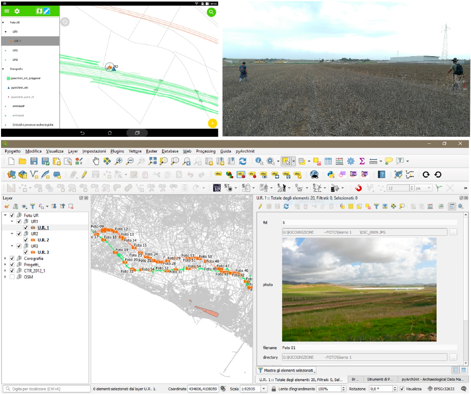

figure 1
Figure 1 - An example of the same Survey GIS platform project in QGIS (below) and in QField (above). Image by Giuseppe Guarino 2019.
Furthermore, similar to QGIS, we can query each layer within QField by obtaining the respective information contained in its attribute table (however, there are also other GIS applications for mobile such as ArcGis, LiPAD, Bentley Map Mobile, GVSig Mobile, Geopaparazzi and others).

The data collected in the field during the survey will be recorded and digitised through three different layers (point, line and polygon). The attribute tables connected to the three layers record the following information: Project Name (String), Municipality (String), Location (String), Feature Number (Integer), Place Name (String), Location (String), Date (Date), Site Definition (String), Visibility (String) and Photos (String).
The attribute values, “Project name” and “Feature Number”, between the two tables must be Unique Constraint in order to identify only one unique “Project name” and only one “Feature Number”.
The GIS platform must also have base maps such as Google Satellite, Open Street Map, Orthophotos and so on. In this case, we used the following maps: Carta Tecnica Regionale (1:10.000), Open Street Map e Google Satellite. To make these maps lighter, we created first overviews (pyramids) in QGIS.
The positioning of the archaeological features identified can be recorded through the GPS internal device. However, for a greater accuracy, QField can be connected to a GNSS antenna.

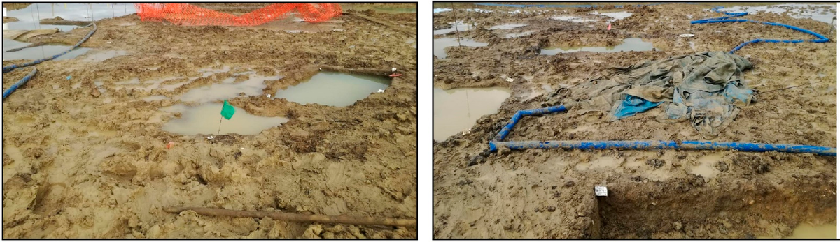

Figure 2 - An example of when the weather and visibility conditions in the field are poor. Image by Roberto Montagnetti 2019.

figure 3
Figure 3 - An example of the same open area excavation GIS platform project in QGIS (above) and in QField (below). Image by Roberto Montagnetti 2019.
In fact, primarily, by using this system, archaeologists who are working in the field will be able to directly register the context numbers identified during the excavation within QField, in the appropriate “context register” table in the QField database.
This aspect already speeds up on-site operations by saving the time generally taken to go back and forth from the site to the compound or from the site to the car/van and vice versa, for the compilation of paper registers; especially, if we take into consideration the fact that, on a regular basis, cars and compounds are located at a considerable distance away from the excavation area.
Additionally, since generally there is only one device on site and this is usually held by the site manager or by the supervisors, this would make it easier for them to check that the field archaeologists are assigning the right numbers to the identified contexts.
Very often, on a location tend to become confused, especially when the excavation area of the site is poor due to adverse weather conditions. Along with the above issues, they can also encounter errors such as registering the same feature with different cut numbers or by assigning the same context numbers to different features.
This occurs even more frequently when the field team is composed of numerous archaeologists who work in separate excavation slots from each other. These slots can be spread around the excavation area, making interaction and communication between them more challenging.
This issue is also linked to another problem, which means, for those who work in the field, it is impossible to have a constant overview of the investigation area and the archaeological features identified, which often causes confusion and making mistakes during the registration of the context numbers.
Therefore, from this point of view, QField represents a real breakthrough by giving the following possibilities to the people working on site, at any time:

QField aids with various challenges encountered in the field: time wasted due to inclement, wet weather and perpetually sodden and muddy soil churned up by people and vehicles continually accessing the site. These cause the identified archaeological features to become unrecognisable after several days of the site being stripped (Figure 2).
By using the device’s GPS, as it allows the user to navigate within the excavation area and to find, albeit with a certain margin of error, the archaeological features that need to be excavated, even when the visibility on site is poor.
Similarly, by doing so, when visibility conditions are bad, it is easier to centre with the slots in the archaeological features that have previously been identified in the Pre-Ex phase, which prevents the miscalculation of digging into the natural sites.
A typical example of this is when there are furrows running across the field, and it becomes increasingly difficult to see their entire length with the naked eye.
Typically, in order to remedy this type of problem, archaeologists use printed maps in the excavation area.
However, although this can certainly be a help, in practice, they are in no way comparable to the convenience of digital maps and consequently to QField for a number of reasons:
1. Printed maps deteriorate very quickly due to wind, humidity and especially when handled by human hands.
2. To contain the entire excavation area, they must often be printed in very large formats, which requires particular.
plotters, which incurs considerable costs and makes them difficult to use.
3. Paper maps are not interactive, which means that you cannot ask them questions.
4. They do not solve the problem of having to precisely centre the archaeological features, which need to be investigated with the slots when the visibility conditions on the site are poor.
