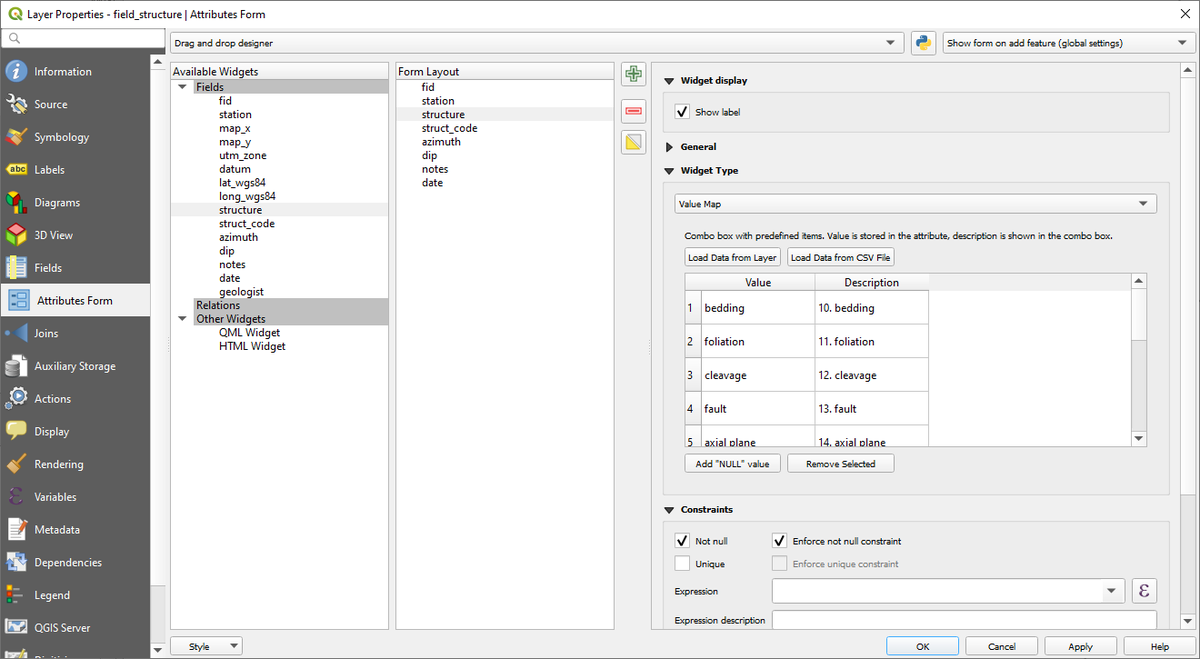

Goal
Project preparation
Coordinates
Structure type
Azimuth and dip
Date
Structure list
Figure 1: Structure list
Symbology and labels are customized for each layer, including embedded SVG symbols for structural features that are rotated with the azimuth field. In addition to field data, base maps and historic data are compiled into geopackages for reference. Base maps include vector topographic data and raster orthophotos. Raster geophysical data and vector geochemical data are included if available, as well as historic geologic mapping. Map themes are designed to quickly toggle between geologic mapping, geophysics, and geochemistry views.

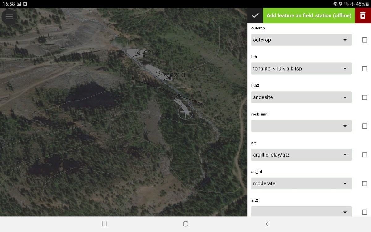

Geologic field
Figure 3: QField form

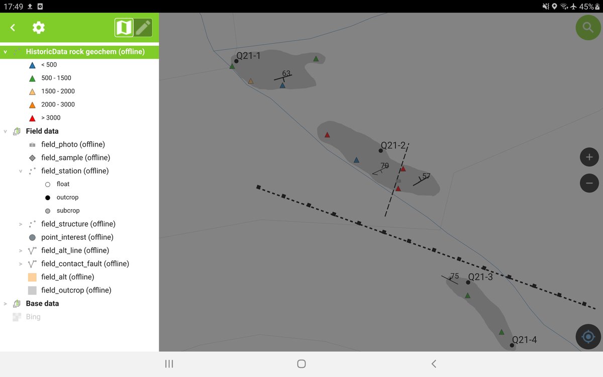

Results
Final geologic maps and analysis are prepared directly from field data sets with no need to digitize field data. Depending on proficiency and type of mapping, the QField geologic mapping workflow takes approximately the same amount of field time as manual (paper) mapping and drastically reduces office data digitization time. Additionally, historic data are easily referred to in the field, allowing for real time interpretation and targeted field work. Maps and attribute tables can be exported directly from QField or the QGIS project for daily field updates or communication between working groups. QField allows for data integrity with customizable attribute fields and database compatibility. Field data quality assurance can be built in during project design, ensuring attributes are consistent between users and reducing human error with constraints and default values.
Geologic field
Figure 4: Map result
